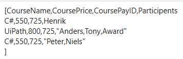

I have this data.
Find the rows with same CoursePayID and then find where CourseName is same and show result and then also show where course name is not same for same CoursePayID. The result should be like this… in One file
