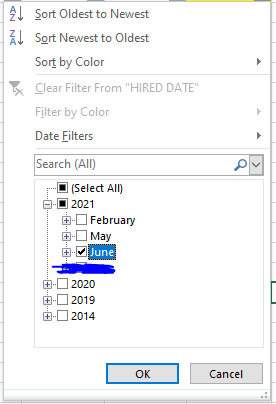

So, I would need UiPath to filter the column of ‘Hired Date’ to such that it only filters the data to only data within the current month.
To further elaborate, here is a scenario. Assuming today is the 30th of June 2021 and I would require UiPath to detect that this is the month of June and only filter data that is within the month of June (1st June to 30th June 2021).
(In excel, when doing manual filtering, it would look like this:)
So after filtering the sample data, it would look like this:
(Where it would only show the data within only 1st June to 30th June 2021)
