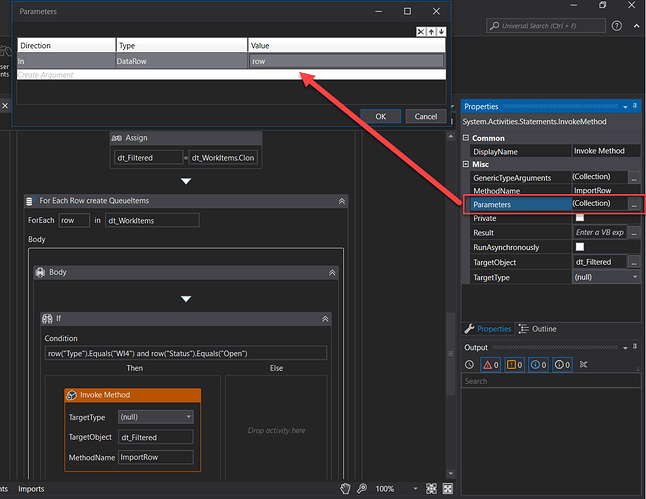

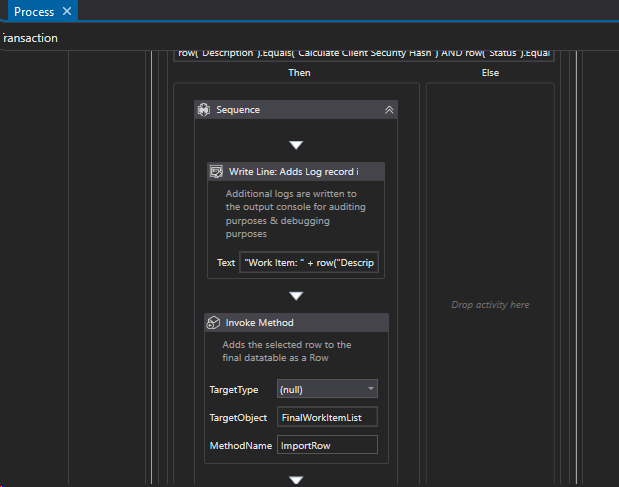

In the IF activity, if the record meets the criteria, you can use a Invoke Method activity to add the particular row to another data table which you can use later to write to the excel file.
This is one example which I have done sometime back…

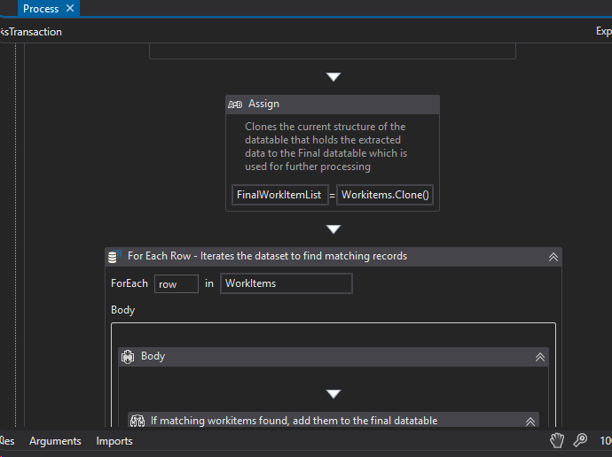

So, just before the For Each Row activity add a assign activity to clone the structure of the data table 1 to datatable 2.
THen use the For Each Row activity to process it…
Check the screenshots below…
I think this suits your requirement… Let know if that helps!!

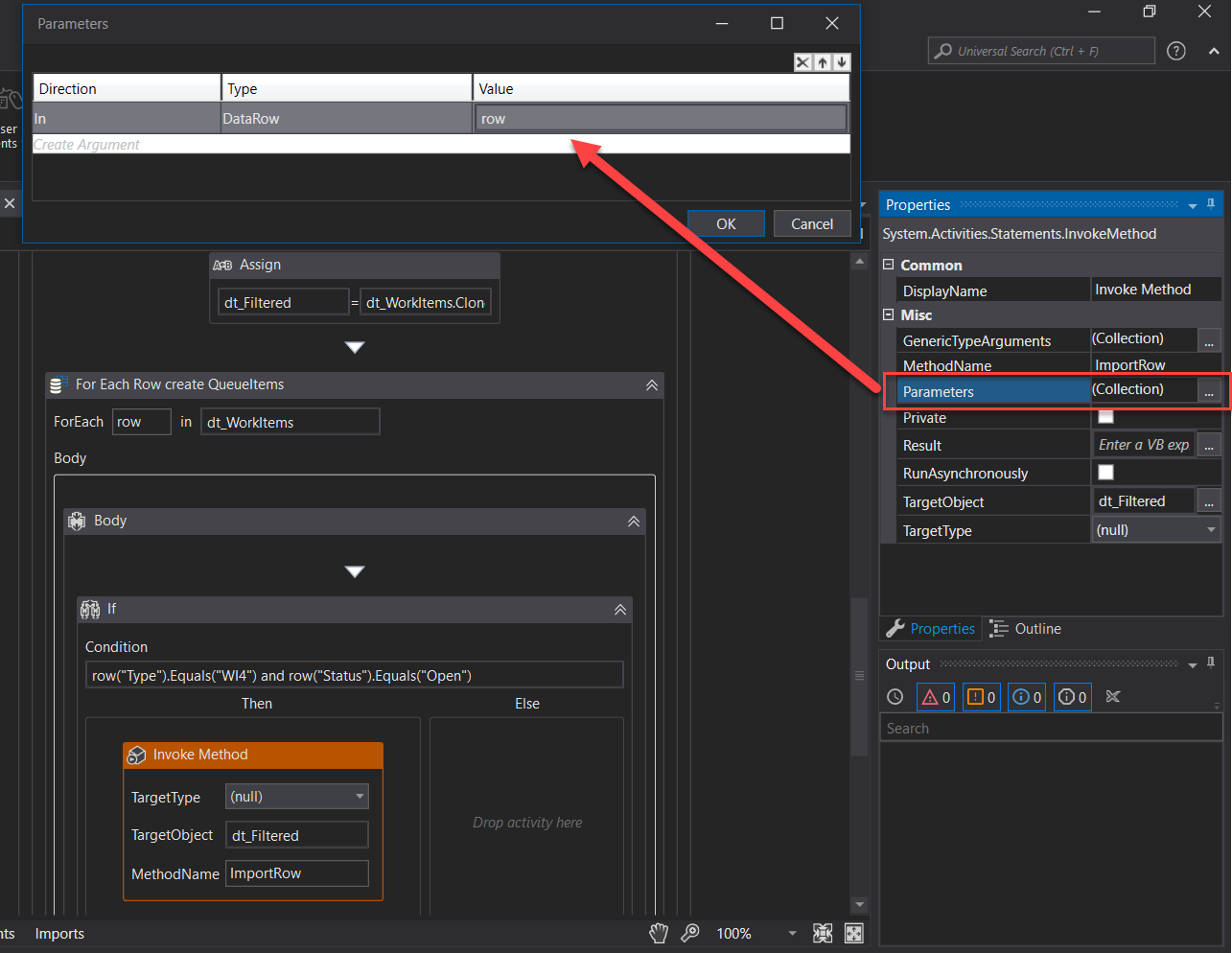

One thing not explicitly called out in your post, is that you need to tell the Invoke Method about the arguments (this might be obvious for most, but in case not):
