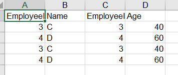

ok, After using joinDt and filterDt, i got this result
is there any way to keep only 2 values actually values are repeating?
Yes , by using the inner join you can get only the common values between both the datatable.
There were two sheets, so i joined them by using joindt and then i filtered the dt and write the result in third sheet and there the output is repeating, so i want to remove the repeating value.
so you want me to again use inner join?
The inner join will have duplicates. You can try remove duplicates rows activity.
