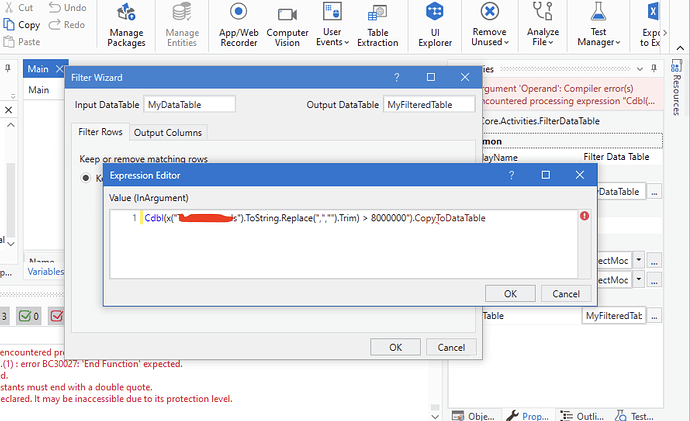

I tried it, it didn’t work, it gave me an error message (when I run).
Probably I missed something.
What I wrote:
Cdbl(x(“ColumnName”).ToString.Replace(“,”,“”).Trim) > 50000000").CopyToDataTable
Screenshot below :
thanks
nounoubks
(Nounoubks)
March 6, 2023, 7:54pm
6

This another try (screenshot below):
Anil_G
(Anil Gorthi)
March 6, 2023, 8:00pm
7
@nounoubks
You have to give whole of this in assign activity…left side will be a datattable again…on the right…you have to give all of this…here dt is the input datatablw where you have your data…
filtereddt should be on the left side of assign activity and is of type datatable
After 80000 I see a inverted comma please remove it. use the formula properly

Hi @nounoubks ,
You need to add the ‘Filtereddt’ on left part of the assign activity and the linq query in right part as shown in below screenshot,
Hope this may help you
Thank you @Anil_G @Manish540 .
Works perfectly!
