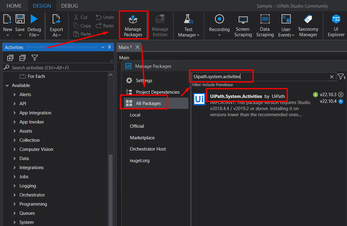

Hi @JOSE_FRANCISCO_URIOSTEGUI
  1. Open UiPath Studio: Start UiPath Studio and go to the “Activities” panel on the left side of the screen.
  2. Install Package: Click on the “Packages” button on the right side of the screen and select “Manage Packages.”
  3. Search for Package: In the “Manage Packages” window, search for “UiPath.System.Activities.” This package contains all the File System activities you need.
  4. Install Package: Once you have found the package, click the “Install” button to install it.
  5. Restart Studio: After the installation is complete, restart UiPath Studio for the changes to take effect.
  6. Use Activities: Once UiPath Studio has restarted, you should be able to use all the File System activities from the “Activities” panel.

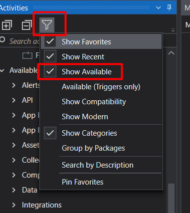

Hello @JOSE_FRANCISCO_URIOSTEGUI
  1. Click Manage Packages-> All Packages
  2. Type and search for UiPath.system.activities
  3. Select the UiPath Official packages and install or Update it.
If already install and updated, you can’t see the activity,
Check this,
  1. Go to the Activity pannel and click the Filter icon.
  2. Ensure the option Show available is enabled.

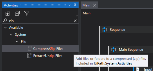

Hola!!
No podĂ­a utilizar la actividad ZipFile, de hecho me habilitaron una liga (eso me comentaron), no pude ver cual fue ya que tuve que dejarles mi equipo.
Muchas gracias.
Claro para eso tienes las siguientes actividades incluidas en el paquete System:
Cualquier duda nos consultas. Saludos!
Gabriel!!
Muchas gracias, y si buscnado encontre esa actividad Compress/Extract!! Muchas gracias!!
