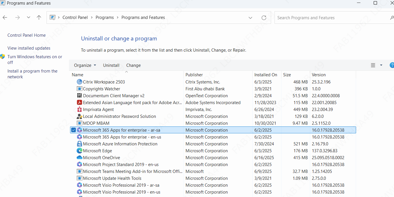

Try change or repair from the prod machine
Control Panel → Programs → Select Microsoft office / Aps → Repair or change
