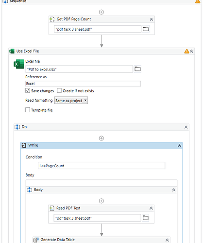

Hello,
Please find the attached Workflow. Plz try to execute this. It will read pdf pages and write to different sheets in the Excel. For doing some more formatting, you use Excel activities and modify the excel. PDF data is not there in a valid table format, so we cannot directly extract it as table.

Package missing and here i am using uipath studio
Hello,
Are you using the modern designer of the Uipath? Are you able to see “Use Excel File” activity?
I have added the screenshot in the last message. You can use that as a reference to create the flow. Else try to update the excel dependencies.
I was using classic designer, I will try to do in modern method.

Ok…Check and update here. The above flow should solve your requirement, but after writing to excel you need to do some cleaning in the excel like Delete rows and columns using automation.
All data writing in single sheet, what changes i have to do. Please look in to attached screenshots.

Check whether variable”i” is initialised. Go to variables set the default value for i as 1
Hope you are using the Excel which I shared along with the project. Else you have to just create Sheet2,Sheet3,Sheet4
Hi @Rahul_Unnikrishnan ,
Thanks for helping, now its working.
