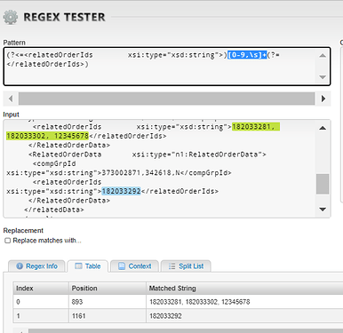

RegEx Pattern: RegEXPattern.txt (86 Bytes)
In the above screenshot, you can see the matched string at the bottom…
@prasath17 Thanks once again. But what if we have more than two id’s at one place
@Shaik.Yezdani…that will also work, I have tested that before sending … please try that and let me know.
@Shaik.Yezdani - I spoke too soon, above given pattern doesn’t work if its more than 2 ids…

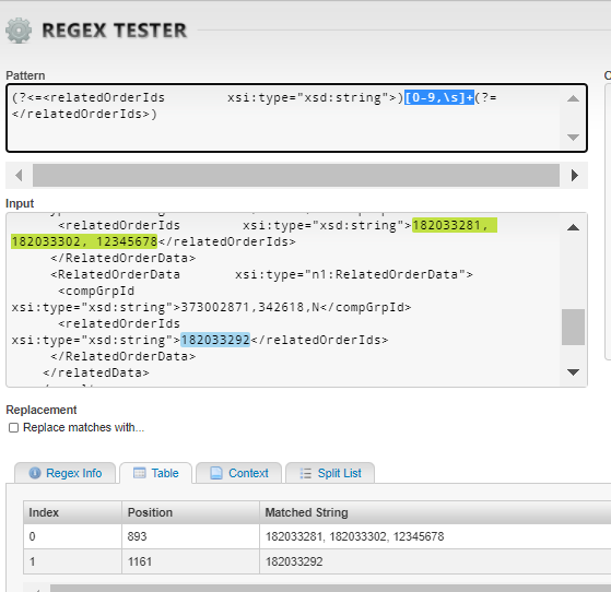

Just change the middle pattern to : [0-9,\s]+
Explanation: This pattern would any digits from 0-9 comma and Space(\s) …

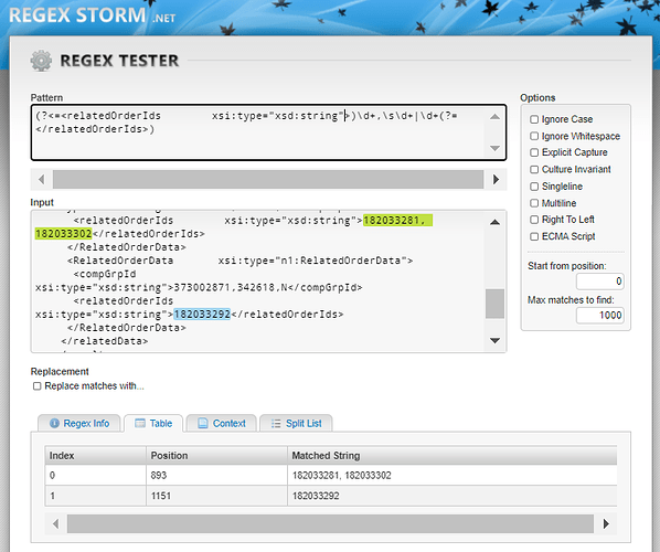

Update: Since there is an extra " inside the pattern…you have handle as shown below
Output:
