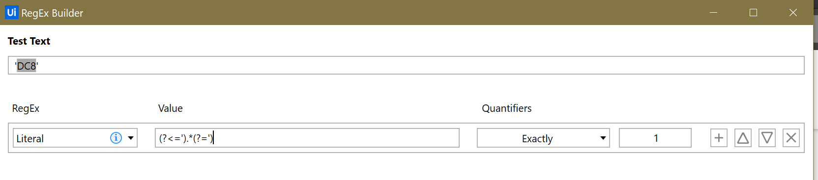

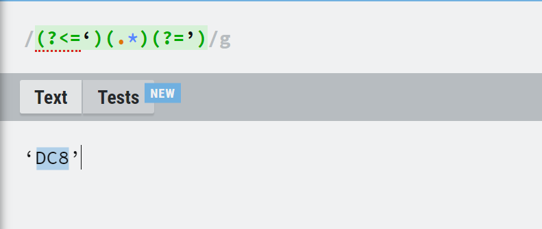

Select ‘DC8’ and click on New
Hi I need to extract the portion within the single inverted ’ '. Can anyone help me with the regex for it. I am new in Uipath
Thanks
Ankita
Thanks
Ankita
How can i extract it and assign it to a variable?
Using matches activitiy and using the regex pattern as suggested by @Srini84. Extract the data from the string and store in a
collection variable s1
then use s1.ElementAt(0).ToString to get the value and u can assign it to a variable
Hope it helps you
Regards
Nived N
Happy Automation
Thank you it worked
