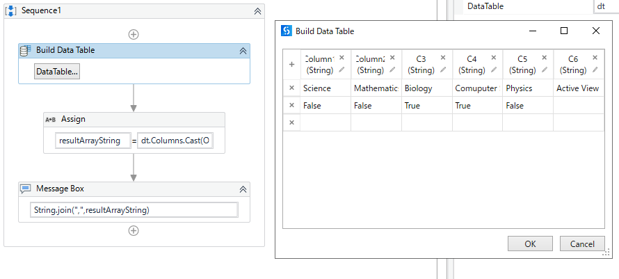

Here is a sample, FYI.
Sequence1.xaml (8.1 KB)
Hope this helps you.
Thank a lot. Its Worked. :grinning:
