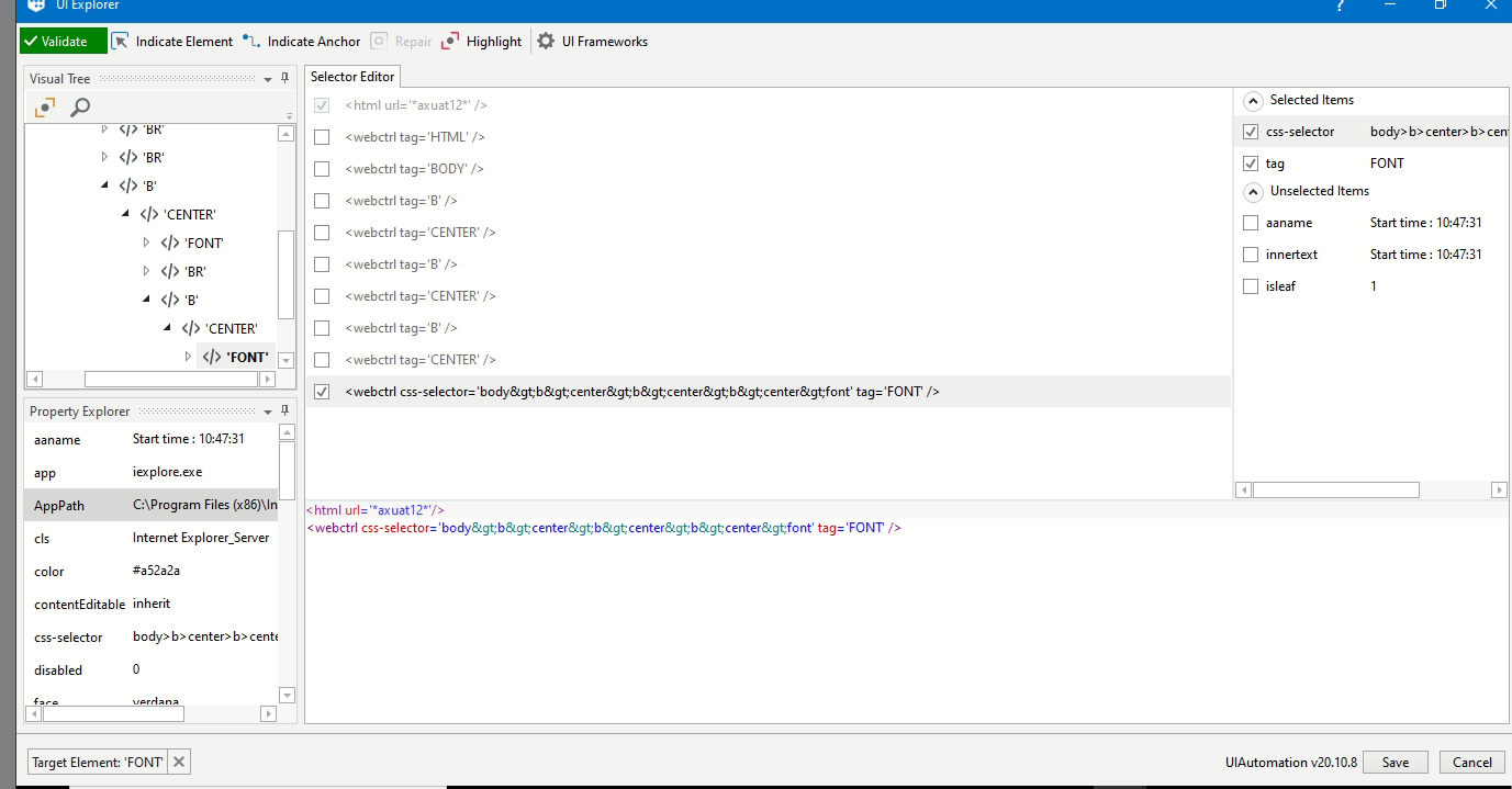

I am Facing this problem and its unable to solve this issue, with wildcards.
still finding out this exception.
Source: Get Full Text ‘iexplore.exe Message’
Message: Could not find the UI element corresponding to this selector:
Exception Type: UiPath.Core.SelectorNotFoundException
thanks in adavnce.

I want to find this css code on wait attribute…
To be clear on the process, the bot is fast than the landing page, i need to take screen shot of the page but the bot runout and its throws the exception message pop-up, So I request how this resolved.
