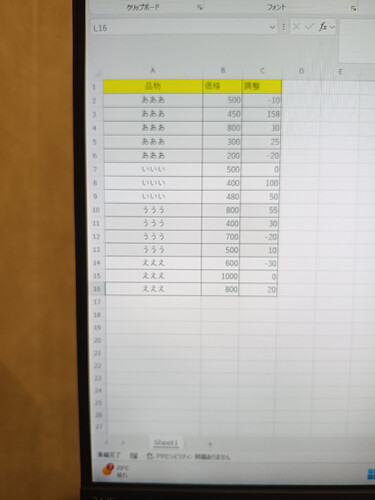

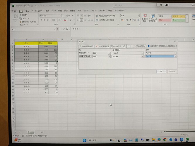

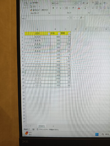

I have a table as shown in the images below, and I would like to apply a “User-defined Sort” for each item like “aaa”, “iii”, “uuu” under “Sort and Filter”. Is there a way to implement this?

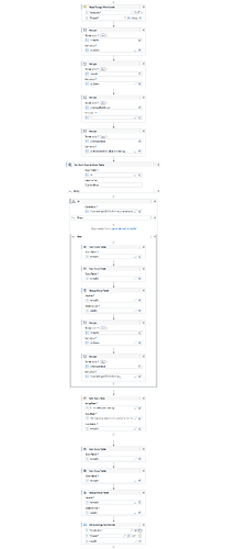

I think there are several methods, but if we create an activity using the approach of scanning through a DataTable, it might look something like the following.
Sample
Sample20260611-3 (2).zip (11.2 KB)
