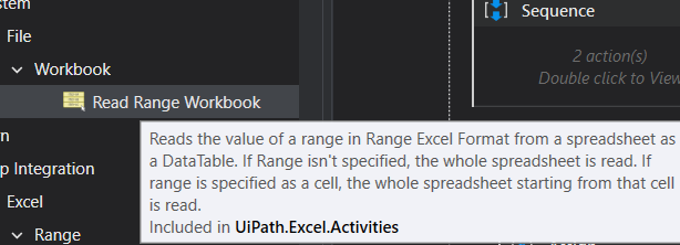

I’ve used “Read range workbook”, but still not working.
