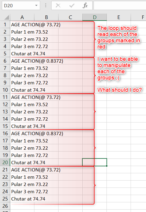

I have an urgent question → how do I loop through a single column (A) and dinamically read the groups in RED (5 in 5 rows)?
Here’s an example of the procedure I want to do:
Thank you!
Hi all,
Thank you!
You can simple calculate the real row number with an assign:
realrow = block * 5 + blockrow
Then read cell(realrow,1).
Hi, thank you!
Would you kindly provide me a .xaml sample ?
@billabong271294 - Please check this XAML ReadBlocks_Excel.zip (41.9 KB) and let me know if this helps you…
What I did was, after reading the 5 rows from the excel, I setting the index count back to 1.
If I ever become a millionaire, you surely will be remembered! Thank you!!
