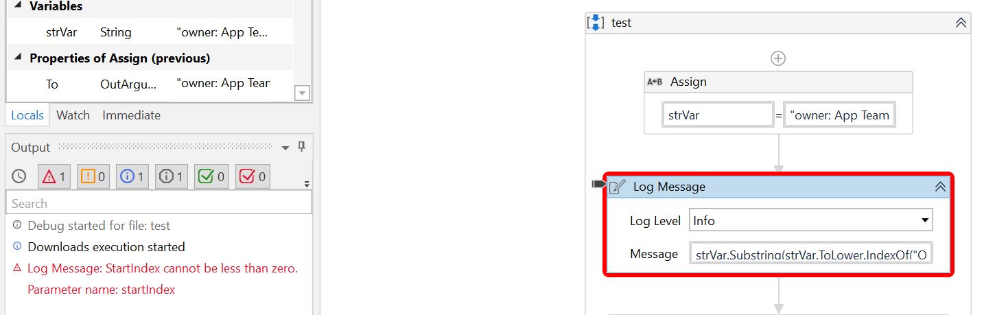

I have changed the “Owner” to “owner” in the Assign box for testing purpose.
Please see the screenshots below which getting an error where using the ToLower.
  • strVar.Substring(strVar.ToLower.IndexOf(“Owner”),strVar.IndexOf(“Purpose:”))
  • strVar.ToLower.Substring(strVar.IndexOf(“Owner”),strVar.IndexOf(“Purpose:”))
Please advise and Thank you
@AL13
But you haven’t change it in inside index of string. Still it is “Owner” change that to “owner” and also change the other strings
