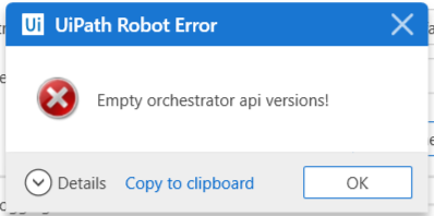

Hello @lakshman I am a beginner and I don’t have much idea about how to do that. However I deleted all the machines and the robots and recreated the robot and machine as shown in the video and while I trying to connect now I am getting different error which is as follow.
