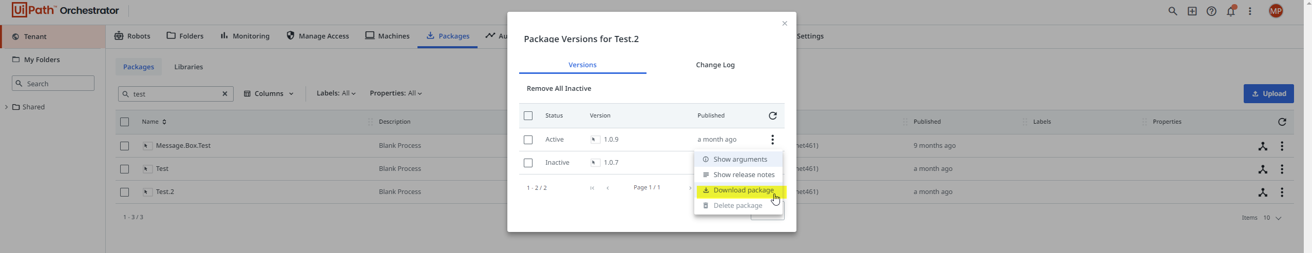

- Access the On-Premise Orchestrator → Tenant → Packages → find the not migrated package process → Version → Download package
