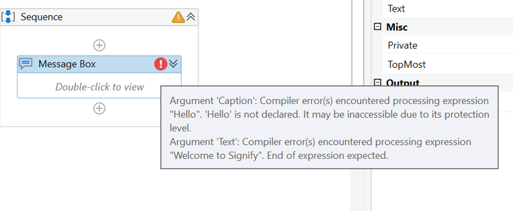

I am getting an error, can anyone help
Thanks in advance!
@reni.sweta, you’ve either declared a variable outside the scope of your sequence or your directly giving hello in the message box value without the double quotes.
If you’re using a variable, try changing its scope or if you’re directly passing hello in the message box, try using a double quote like “hello”.
Kindly verify.
It happened for “hello” and accepting “hello”“” but what is the reason behind?
All string are enclosed within double quotes so if you want the message box to display hello + username for example, you need to concatenate the string “hello” with the variable that holds the username.
Is it working now by the way?
