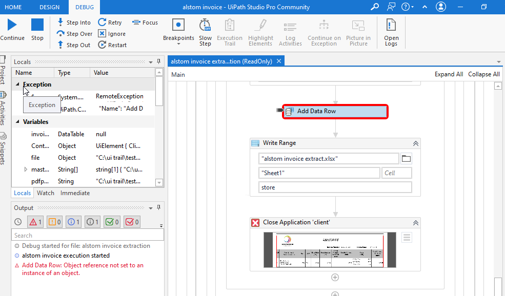

Hi guys,
tried to capture data from PDF file. where i got held up with attached error. can any one support how to get out of this
Hi guys,

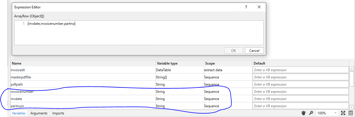

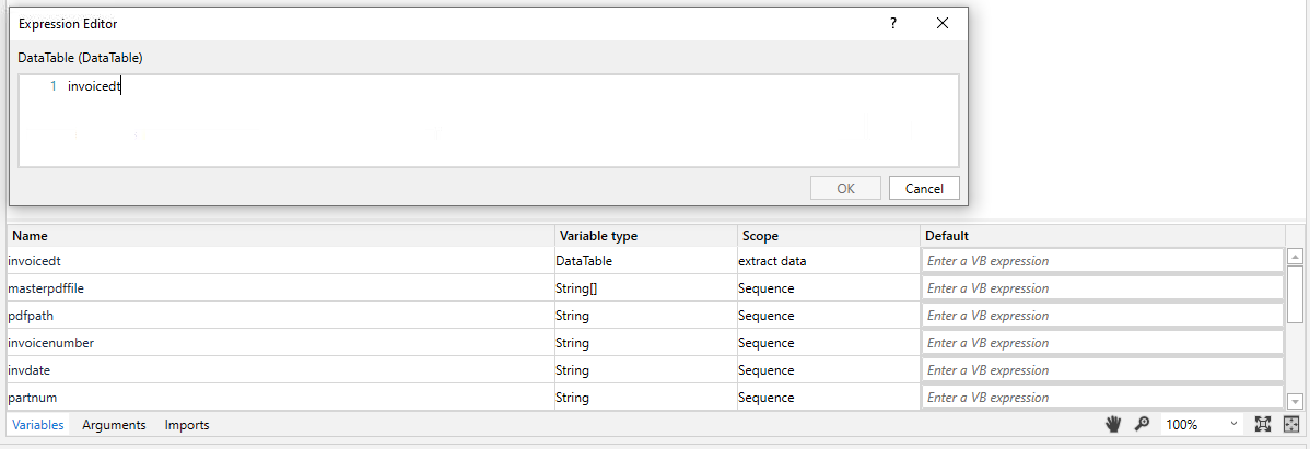

because you didnt initialize your invoicedt variable,
your readstore variable is initialized so you can use that instead
you can change this to readstore
and change this to readstore

Please try this file
alstom invoice extraction.xaml (29.2 KB)
hi jack. thankyou very much.
its working. You have given quick solution.
no problem, please mark my reply as solution.
thanks jack. you have given a quick solution and it helped me a lot.
