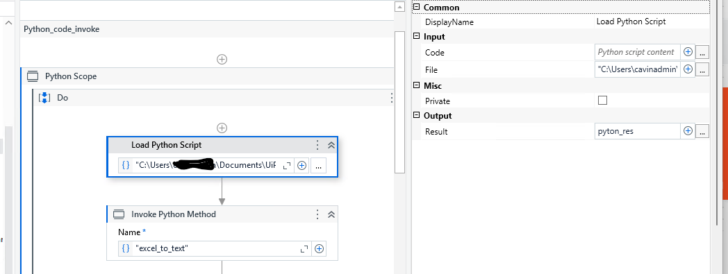

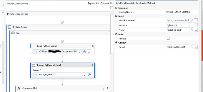

Could you share the Python version installed and the properties panel for Python Scope activity ?
Python version is 3.8 and also attached property of Python scope and other activities as well.

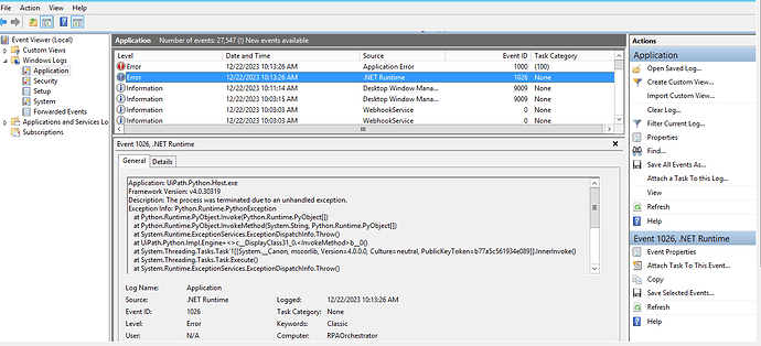

  2. When the exception occurs open the event viewer logs and check what error it shows…
depending on these we can determine next steps

Hi @Anil_G
Attached exception details from the local panel and as well as from log viewer
Thanks for the suggestion but still getting the same error

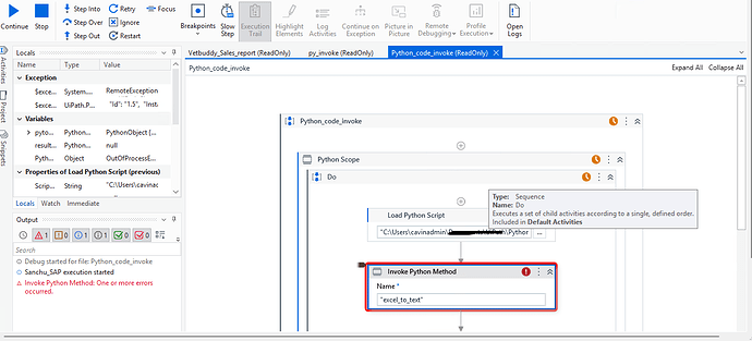

@sathish_Kumar6
In locals panel please expand exception details that is when we cna see the issue
also as per error looks like the python installation is faulty…can you check if you have used any env…and also if path variable in windows environment variables is correct

in the local panel, I’m getting errors as invoke python method one or more errors occurred.

@sathish_Kumar6
You are checking outputs panel…open locals panel…exception details by clicking on magnifier
This is where you need to expand
