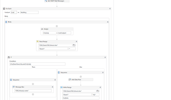

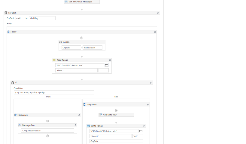

I need to extract and paste a series of serial numbers from subject of the mail to an excel sheet such that the same serial number doesn’t enter twice in excel sheet. I’m having difficulty in getting the right “If” Condition. If someone could help me with that I’d appreciate it…thanks
Inside the mail loop, You have to use another loop through the Datatable and then in If conditions you have to mention
row(“Columnname”).Equals(CrqSubj)
I tried that as well…it gives an error that says “Collection was modified; enumeration operation might not execute.” and the condition in the above screenshot enters the duplicate data

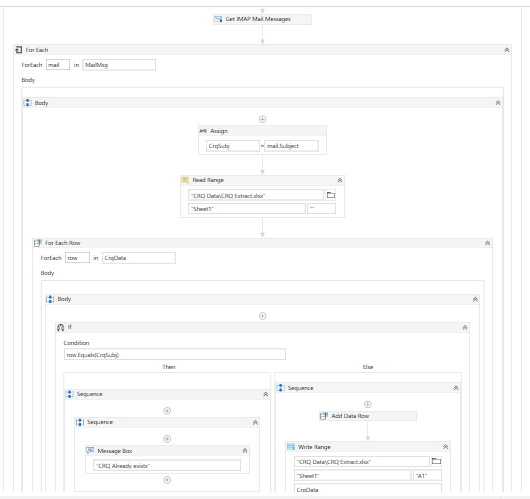

This method uses the for each row for the datatable but it gives an error saying"For Each Row: Collection was modified; enumeration operation might not execute." which I am not able to figure out

I tried that method…its gives the same error…Basically whenever I use for each row for the datatable I get that error and when I don’t, the if condition doesn’t work and the same element is entered twice
