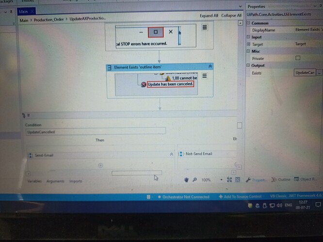

Element exist instead of using any another activity
Hai everyone,
I am using element exist activity for one workflow its work find for me but whats happening means it will take time to do else part. In the below Image I attached
If that update cancelled comes means then (then) part will do fastly but it’s not coming means It will do else part that’s also doing correctly but taking time their so any there is any other activity look like this instead of using???
Thanks & regards,
Sivasankar.

If I used timeout means it will not their( update has been cancelled) it will do suddenly else part without taking any seconds.
@siva_sankar
Use find element activity !
If Specified element found Then or else Part!
you can use like.
Do{
ElementExist with Time out: 1 sec and name of activity: Existone
}While(Existone =false)
i.e. Inside Do while it will work fastly, Instead of taking 30,000 or 1 sec but it will work only when it will enable i.e. either 3 sec or 35 sec.
This workflow only if you don’t want else part. of If condition and Element exist will be always true but take some time
Let me know, if any doubt
Can you explain one more time to do (How to do in do- while) because existone is a activity is their
Thank you :blush: this is working for me :relaxed::blush:
