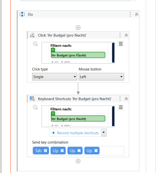

Hi @MdFuadHasan ,
Could you maybe check with the below post :
When a key event solution is to check (can be fragile, but can be controlled on cross checks)
Click: Your Budget … Text
Shortcuts: TAB+up+up+up… moves the min limit
Shortcuts: TAB+TAB+down+down+down… moves the maxlimit
