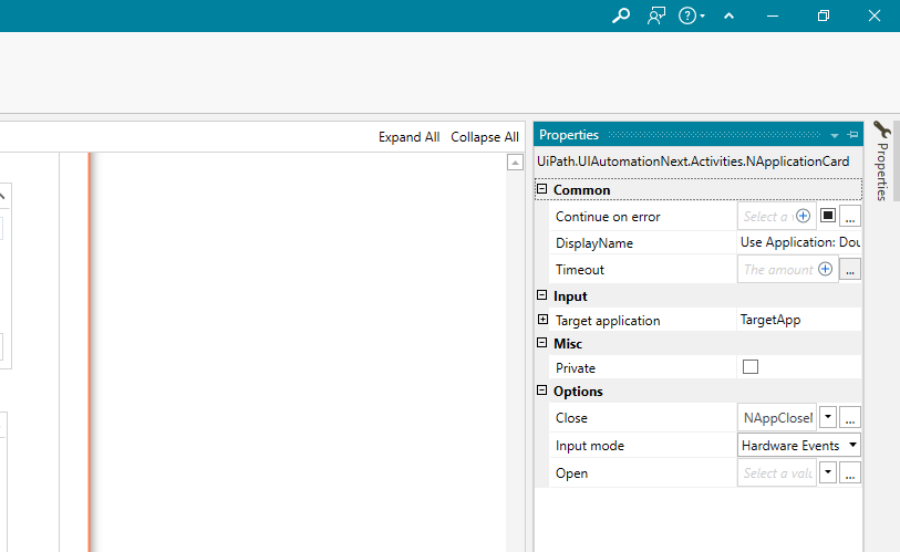

There is a property in the Use Application box called “Close” under the options section:

Sorry, I have the same question, applicable to all aps used in the exercise. where can we retrieve this ‘Close’ option? thanks!
Hi @Lucia.D - please take a look at the screenshot of @bdrever - you can see the “properties” panel in the right upper corner. If you click there the shown properties will open and you can configure how the applications opens and closes

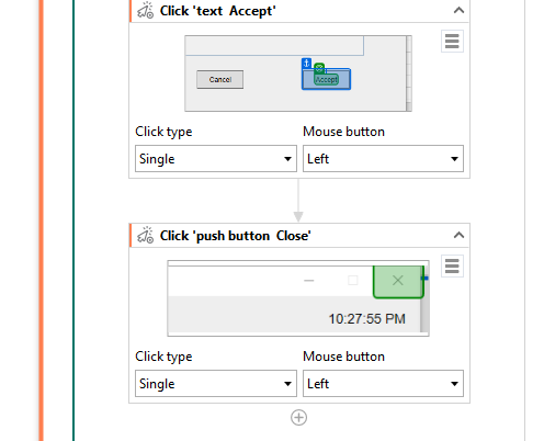

You can add a click activity and tell the bot to close the DoubleUI application as below
