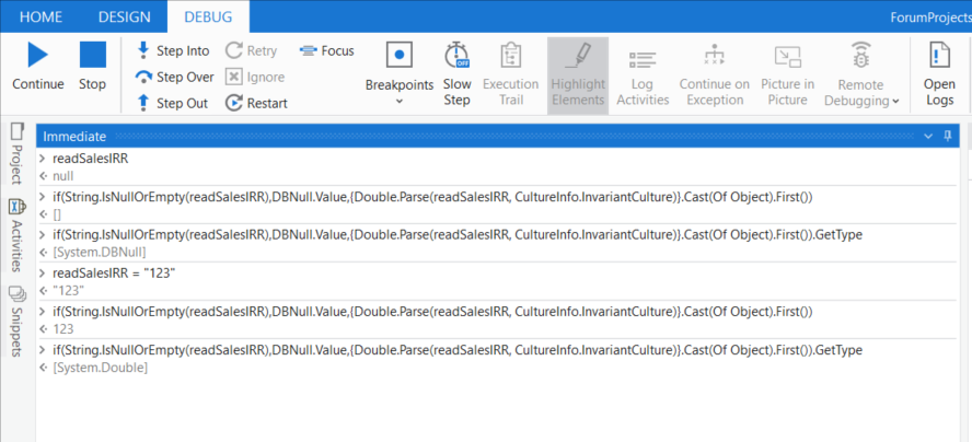

the validation message about is that the IF is not returning always the same datatype
have a look here
set the variable datatype to Object for harmonization reasons. Later the correct datatype will be used as showcased within the immediate panel
if(String.IsNullOrEmpty(readSalesIRR),DBNull.Value,{Double.Parse(readSalesIRR, CultureInfo.InvariantCulture)}.Cast(Of Object).First())
a less wired alternate could look like:
if(String.IsNullOrEmpty(readSalesIRR), DBNull.Value, DirectCast(Double.Parse(readSalesIRR, CultureInfo.InvariantCulture), Object))
