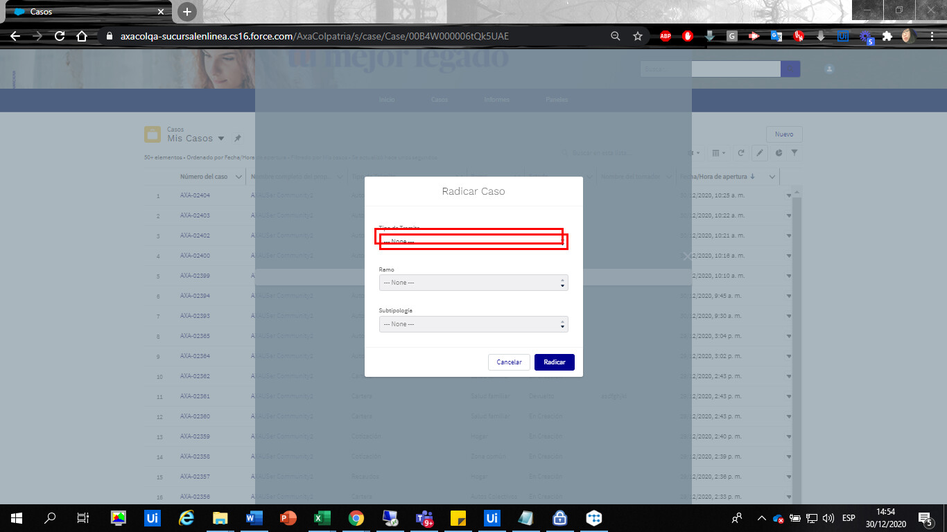

hello, I’m getting a drop-down list with selctItem but it dragged me double selector, I don’t know how it could be solved, someone who can help me with the inconvenience. thank you very much

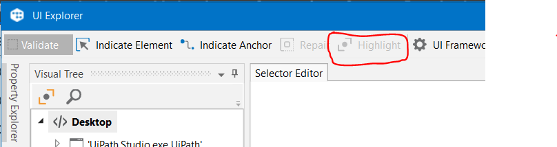

You can open the UiPath Explorer and check if your selector is valid.
Hi Samy,
Check the highlight is enabled in the selector screen in properties or in UI explorer and disable it
