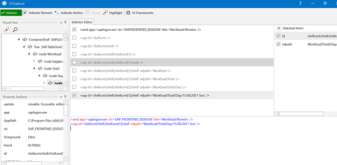

1st row need to be selected.

I have tried “Double Click” activity and tried an desktop app using it but it is behaving like single click.
Moreover, If I am trying the same sequence execution using “Double Click Image” then it is working fine. Can anyone suggest why this anomaly is happening?

I have done the same. But still same issue. it is getting selected whatever we select/indicate. irrespective of that everytime only 1st row in that node need to be selected.

@priyanka.donakonda
Have you tried using select item?
Regards
@pravin_calvin
In Select item we have to provide the text. Here the text will not remain same everytime. The date which you can see in the image will change everyday.
So, it should click the top1 in that node during automation
Thanks
Priyanka
@priyanka.donakonda
Can you share me your selector which you re using for a click?
Regards
@pravin_calvin : in Relpath that date shouldnot be given…instead it should select top1 row.
Thanks
Priyanka
