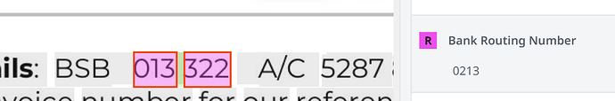

I am trying to train an invoice model with some data. However for a field even if I tag the correct data the values that comes in the field is not correct.
I am tagging value 013 322 but it appears as 0213. Any idea how to resolve this issue?

I am not trying to predict by am actually highlighting that value in the invoice and clicking the shortcut “R”. But this the value that comes up in the field.

Thanks a lot for getting back. Actually I tried to load another new sample and tried to map this field first. All other fields are blank. But still it is showing the value incorrectly.
Can this be an OCR issue or something wrong with the pdf?
It was extracting it as two values and showing it as wrong… @nanmishra
Delete it and Map again by Selecting both and click on Enter then Click on R.
Can you try this.
@mkankatala …Thanks and really appreciate your help. I tried to select both and press enter and then press R. But it is still not working. One thing I noticed is that there is one block between both the values. If I select that it gives value A which is not visible on the pdf

It was an OCR issue in the pdf. We asked the vendor to correct the pdf.
