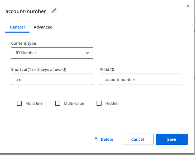

Field Settings:

Hi @Laura_Hubbard
Can you check on multi-value and try it
Hi @Laura_Hubbard ,
Since maybe there are spaces around it the ID Number type might not be recognising it in accurate manner.
Does it work when there are no spaces within the account number ?
Could also try by changing the Content type to String and check whether it is able to extract properly.
In the data labeling session, make sure that the entire account number, including spaces, is consistently labeled. If the labeling is inconsistent, it may impact the model’s ability to recognize the complete account number.
We grouped all numbers in the line using the ‘/’ key and marked the field as multi line. This appears to be working to pull the full account/meter number.
