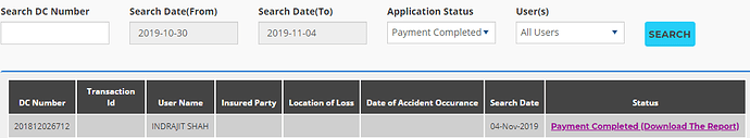

-Select item from drop down and click search(above attached 1st image will appear with records)
100 records will appear in every page
-click Payment Completed in status column to download.
-once downloaded, status will be changed.(see 2nd image).

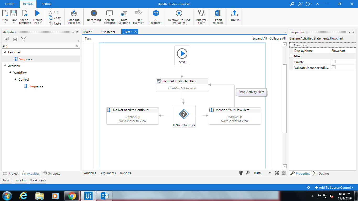

@indrajit.shah You can directly use ElementExist Activity where pass No Data in ElementExist
So it will work as :
I don’t think this will work for me, as i have to click search after downloading all the records on the page, as on click search the new set of records will appear if there is any.
The above scenario says that : It will work until u get no record.
So if u have new set of data then in this case it will work the functionality part.
Hope this will help.

  1. From drop-down i will select “Payment Completed (Download The Report)” and will click search,It will return only records having “Payment Completed (Download The Report)” status(refer 1st screenshot from the top), Limited <=100 records will load on the screen.
  2. Once i click downloading, the status will be changed to “Report Downloaded Completed” and it will move to next record and so on.
  3. Now to get more records of the status “Payment Completed (Download The Report)”, i have to click on the same search to populate the next set of records if any else it will return “No Data”
