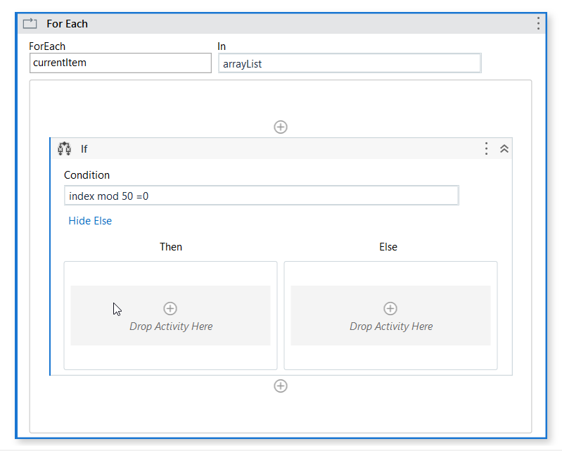

Hi @vinjam_likitha ,
There may be different solutions, but my suggestion would be to use the mod operator within an if statement inside a for loop. Every 50 iterations, the can enter the if block to download the report and reset the page to its logged-in state. I hope this gives you an idea.
