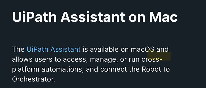

  1. Only cross platform automations can be run on mac os and not windows or legacy automations…so even if you develop using studio your compatibility selected should be cross platform
  2. When you setup a machine as template the configurations should be similar which is not the case here so you need to setup two different…means if all machines are look alikes then machine templates work…else they would not…important one to note below is same physical setup
Hope this clarifies
