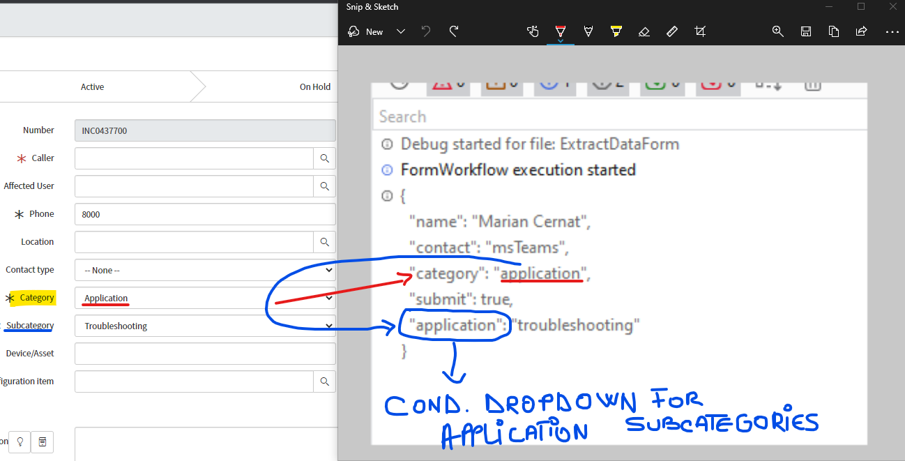

Hello again @Nithinkrishna !
VariableName(“value”) will work for Forms Text Fields and Drop-Down Lists, but sadly, it won’t work for conditional Drop-Down Lists. If the Field Key > Property Name could be the same for every conditional Drop-Down List, then this wouldn’t be an issue anymore. Every conditional Drop-Down List has a different Property Name (“account”,“application”,“cloud”,“database” and so on).
This is where the issue occurs. If the user selects the Application category, a hidden conditional field is revealed to allow him to select a Subcategory for the Application category (Troubleshooting). At this phase, if the first Write Line activity in the workflow is ValueName(“account”), the workflow will stop with the previously provided error message:
Write Line: The given key was not present in the dictionary.
The Subcategory field key/property name (in blue circle) will change from case to case, based on what the user will select in the Category field, and I don’t know how to store it, since it is not the same field key with every case.
Thank you!
Sorry @mcernat for delayed response.
Just try this please…
subOutput(subOutput("category").ToString).ToString
Thanks
#nK
Hi again my friend @Nithinkrishna!
It is working!!! You are the best :robot:!!!
One last question and we can close this topic. How can I transfer the result form subOutput(subOutput(“category”).ToString).ToString to a new variable, since I already have the subOutput variable created.
I need to use the result from subOutput(subOutput(“category”).ToString).ToString in a Type Into activity.
When using subOutput(subOutput(“category”).ToString).ToString in a Type Into activiy, it won’t input anything in the browser UI, even when the Deserialization and User Browser activities are part of the same sequence.
Thank you very much!!!
Actually it should work directly in TypeInto if all variables are in scope
If not you can just assign it to a new string variable using assign activity and pass it to TypeInto
Both ways should work :innocent:
Thank you
#nK
Hi @Nithinkrishna !
Thank you very much for your help on this problem.
I have created a new variable where I have stored the value from the conditional dropdown CategoryOutput(CategoryOutput(“category”).ToString).ToString
The new variable looks like this
SubcategoryOutput(CategoryOutput(“category”).ToString).ToString
One quick note, I have no explanation for it, but to make it work, I had to clone the first Type Into activity. Only in this way, it will type the value into the UI element in the browser. It doesn’t matter if I will disable one of them, in which order, or if I delete them both to create a new one from scratch. It won’t work.
I tried adding a delay between activities, adding extra anchors and other combinations to no avail.
Thank you very much for your help as you’ve been very kind!
I hope that whenever you need some help, someone like you will do the same for you as you did for me.
Peace to you my friend, and for your loved ones.
