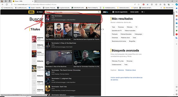

The objective of the course is to be able to refine or create a descriptor for the imbd page, which selects a movie among all the ones there are.
The problem is that if I change the movie I cannot generate a descriptor, with a good enough anchor so that if I change the movie it will choose the movie correctly.
Clarification: it is an exercise in descriptor refinement, the idea is to work on the drop-down menu that appears when we write the name of the movie. I am not looking for solutions that go outside that context.

Hi! the idea is to work on the drop-down menu that appears when we write the name of the movie.
Go to https://www.imdb.com/ and search a movie, You will see that a list of movies is displayed according to the name you enter in the search engine. The idea is to generate a descriptor (Target and anchor) that allows you to click on the cell that contains the searched movie.

Ok, I’ve tried it like this, but it turns out that when I choose the name of a movie that doesn’t appear first (for example: Alabama), the target doesn’t find it, and the anchor ALWAYS points me to the first element above. I can’t find a way to refine them to achieve a reliable selection.
I spent many hours trying to achieve it, I give up. I think this exercise is impossible
Thanks any way.
