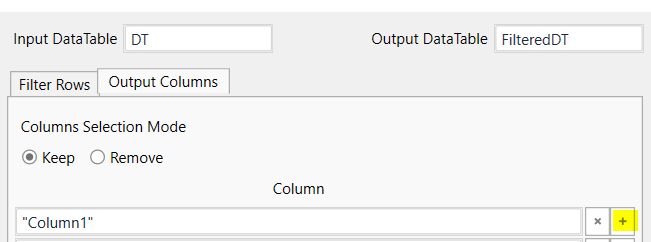

Hi @ppratz,
you can simply mention columns you require or you want remove in Filter Data Table activity, as shown in below shot,
You can use above highlighted radio buttons to particular apply action.
Hi @samir,
Can we mention all the column names(Column1,Column2,Column3 …etc )under one column value?
If so please tell me how can i do that?
@ppratz
Nope, you have to click on plus (+) to add more column names… as shown in below image.
Instead of adding more no of columns, if you want to remove 1 or 2 columns you can simply select remove radio button and mention columns which you want to remove from datatable.
