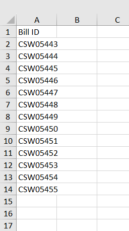

here is the sample sheet where I need to remove “S-” from Bill ID

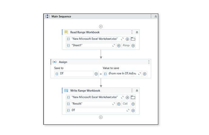

Here is my workflow

Hi @Rohit_Kamble
Can you try the below
(From row In DT.AsEnumerable()
                   Select DT.Clone.Rows.Add(row.Field(Of String)("Bill ID").Replace("S-", ""))).CopyToDataTable()
Output:
Cheers!!
