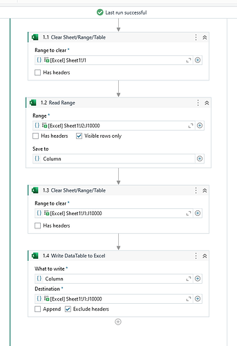

But per my understanding you are trying to delete only cell J1 and shift the remaining cells up in that column.
Solution I would use (it needs a little bit of logic since there is no “shift cell up” activity")
  • Use “Clear Sheet/Range/Table” activity to clear the J1 cell
  • Read the remaining cells above using “Read Range” activity (only read column J starting from cell J2) and store it in a variable
  • Clear the entire column J using again “Clear Sheet/Range/Table” activity
  • Paste the values stored in the variable to the column J again, this will shift the original content up
Results will be from a table like this:
To a table like this:
I have attached the UiPath project in case you want to test it :slight_smile:
Deleting_Columns_Rows.zip (66.8 KB)

Hi, per my understanding you are reading the content from a text file and then using “write data table” to generate this excel file, in that case, after generating the excel file you will need to use “read range” only in the column J (like my example) to generate another data table specifically for that column J (and the datatable variable should be a different name to avoid confusion and overwrite data from the wrong datatable) and then write this range in the column J. Not sure if that was your doubt, feel free to share more information and I can try to help :slight_smile:
