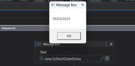

Hello all after writing DateTime.Now I am getting output as 3/3/2023 16:03:01. Can someone tell me how can I exclude time from it and only keep the date.
Thanking you.

Hi @Hardik_Durgam
Try DateTime.Now.toString(“dd/MM/yyyy”)

→ DateTime.ParseExact(Effective, “MM/dd/yyyy 00:00:00”, System.Globalization.CultureInfo.InvariantCulture).ToString(“MM/dd/yyyy”)
Effect is my variable
