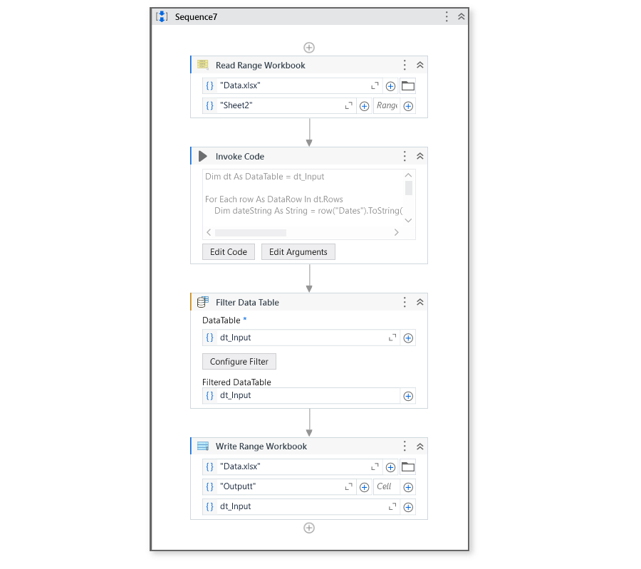

Hi @0bb4628e217fd43ac86ac9294
You need to convert the date format as dd-MM-yyyy
CODE:
Dim dt As DataTable = dt_Input
For Each row As DataRow In dt.Rows
    Dim dateString As String = row("Dates").ToString()
    ' Check if the date format is "d/M/yyyy"
    If DateTime.TryParseExact(dateString, "d/M/yyyy hh:mm:ss", CultureInfo.InvariantCulture, DateTimeStyles.None, Nothing) Then
        Dim originalDate As DateTime = DateTime.ParseExact(dateString, "d/M/yyyy hh:mm:ss", CultureInfo.InvariantCulture)
        row("Dates") = originalDate.ToString("dd-MM-yyyy")
    End If
Next
Input:
Output:
Sequence7.xaml (12.4 KB)
Cheers!!
ok, now it’s converting?
If you want to filter the dates with present date then use the below workflow
Output:
Cheers!!

Hello @0bb4628e217fd43ac86ac9294
It seems like the input date format was changed to MM/dd/yyyy from dd/MM/yyyy and your robot is handle like FEB 1.
So you need to swap it to the format that you expected like @lrtetala showed you above, but in this way (changing the input date format):
If DateTime.TryParseExact(dateString, "M/d/yyyy hh:mm:ss", CultureInfo.InvariantCulture, DateTimeStyles.None, Nothing) Then
        Dim originalDate As DateTime = DateTime.ParseExact(dateString, "M/d/yyyy hh:mm:ss", CultureInfo.InvariantCulture)
    End If
Note: Other way is probably using the new activity to format the date to text on v23.10 within a loop.
Hope this was helpful.
Thank you @lrtetala @Pavan_Kumar177 for your help my code is working fine now.
