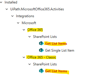

What version of UiPath.MicrosoftOffice365.Activities are you on? Which of the Get List Items activities are you using, the “Office 365” version or the “Office 365 - Classic” version?
