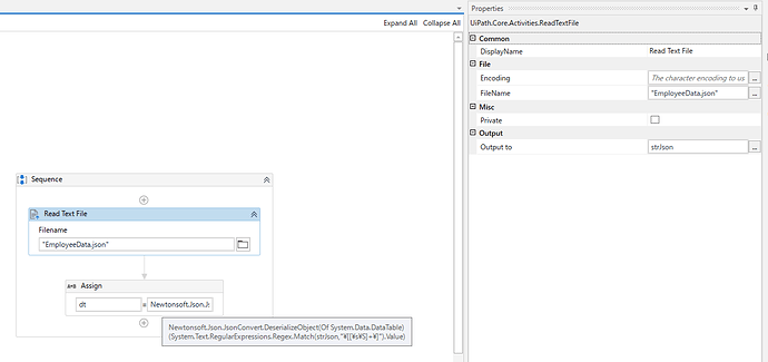

By the Way, I used this activity to convert json to datatable: JSON / JArray Conversion Activities - RPA Component | UiPath Marketplace
In this case, the following will work.
dt = Newtonsoft.Json.JsonConvert.DeserializeObject(Of System.Data.DataTable)(System.Text.RegularExpressions.Regex.Match(strJson,"\[[\s\S]+\]").Value)
Note: Please install UiPath.WebAPI.Activities pacage via package manager.
