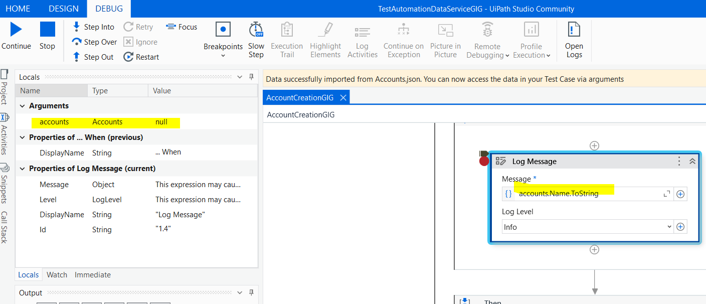

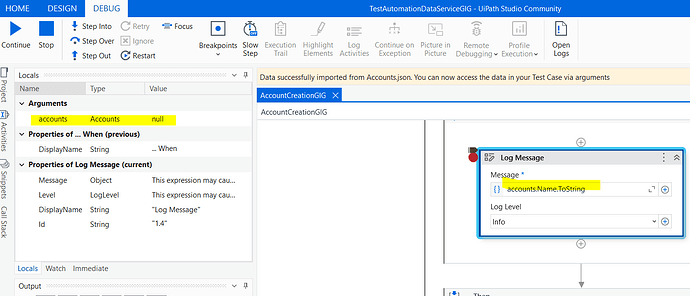

DataService Entity added as test data source returns null in Test Automation

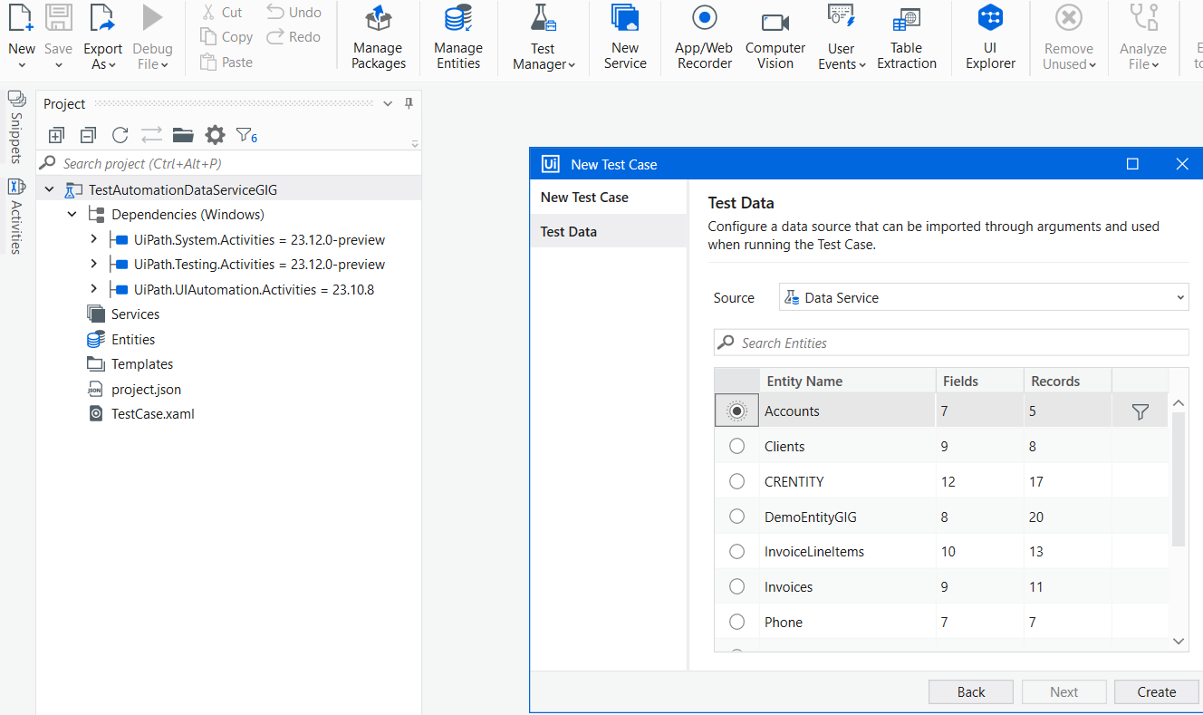

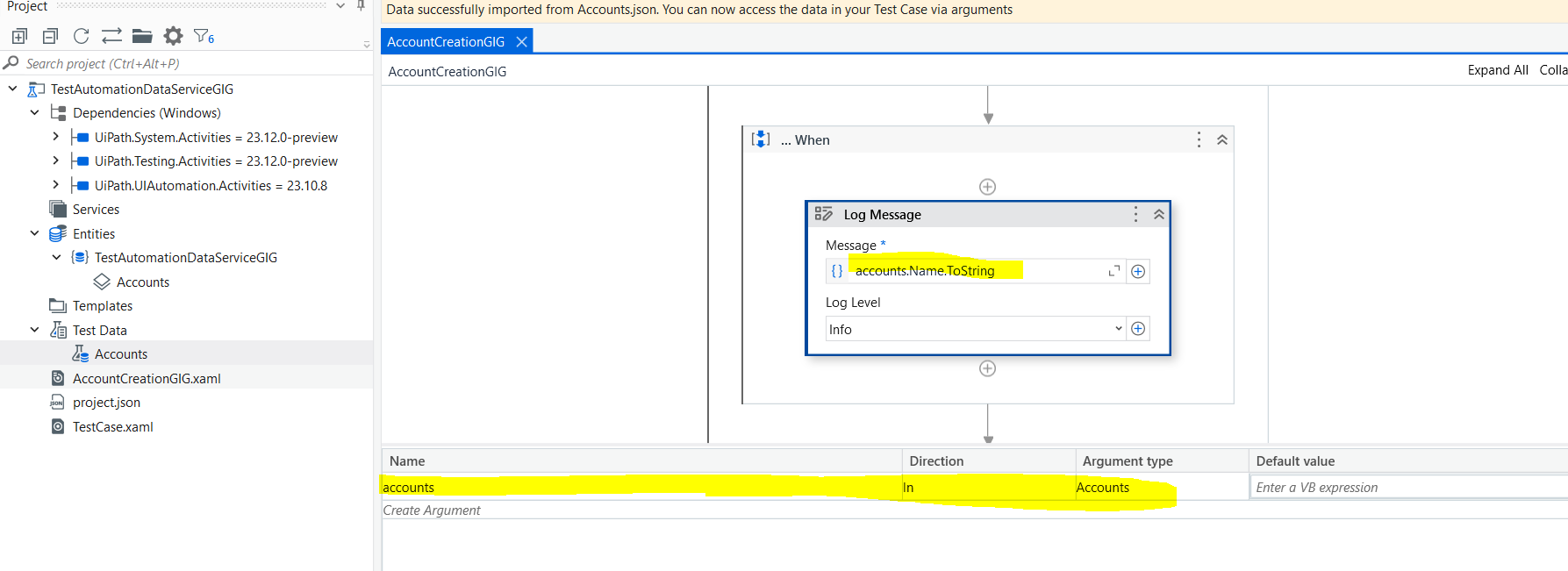

In Test Automation when a test case is created with datasource for test data as data service entity,the entity gets added but it reurns null while running the test case .
It is not fetching the test data from the entity at runtime and throws object reference error as it is null.

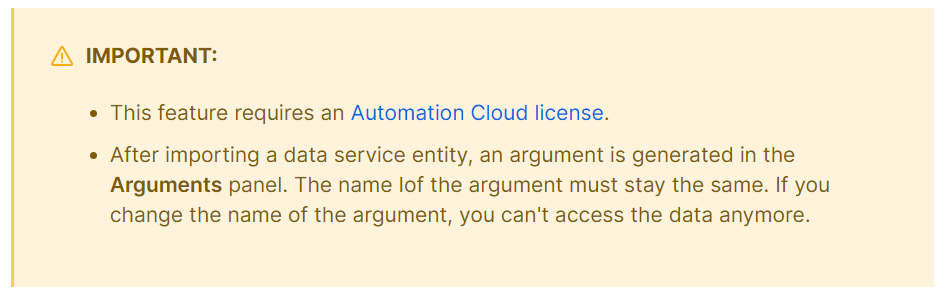

Looks like you created or modified the argument…The argument gets auto created when you link the service and it should remain same
cheers
Hi @Anil_G ,
I didn’t create or modify the argument .It got generated when I attached the entity as test data.

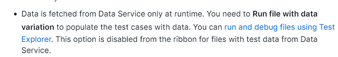

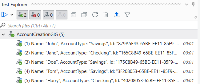

However, after facing this issue I closed the studio and then ran it from the test explorer, and it worked successfully without any errors.Whereas if we run the same thing from the Design/Debug Ribbon it fails and throws same error.
Updating and closing the issue with the workaround,hope this helps someone facing similar issue.

@gRao
Glad you resolved. FYI
cheers
@Anil_G …Yes thats the catch in the documentation, however it would be good if this could be run from both places
