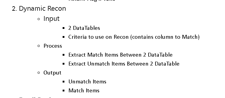

Hello Community,
The below-mentioned task needs to perform in the library(reusable component). can anyone suggest to me how to create the flow for the below process?
Hello Community,
Hello Community,
can anyone guide me through the flow?
