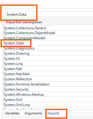

OK, you can add import below namespace
  1. “System.Data”
  2. “System.Data.DataTable”
