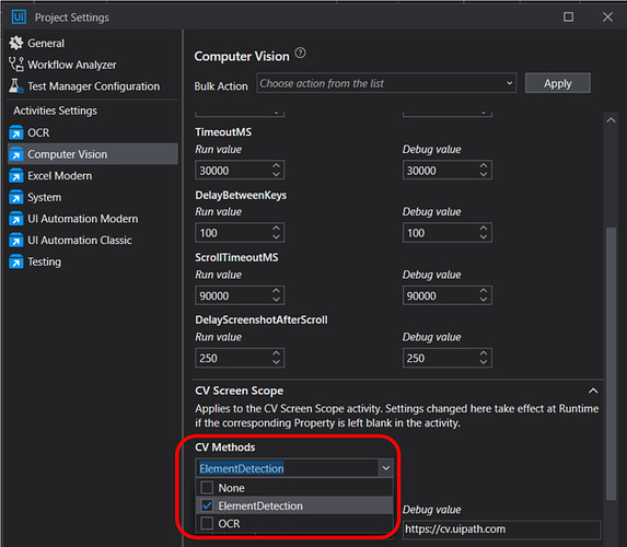

Alternatively, you can also disable OCR processing from Project Settings > Computer Vision > CV Methods:
if your automation can be designed and run using UI Elements alone. While testing this, we found a bug in Localserver 22.7 - it seems the Localserver ignores this setting, so we’re fixing it in the (soon) upcoming 22.12 Localserver release.
