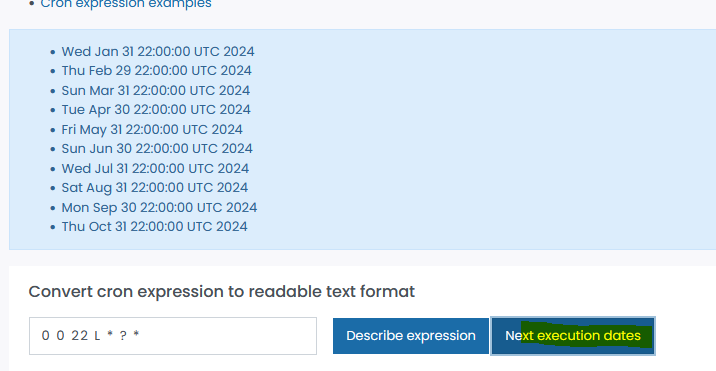

The Cron Expression will be
0 0 22 L * ? *

The above cron expression will be esecuted in these dates
