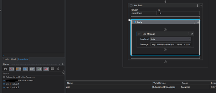

Hey, it’s pretty easy. If you are assigning the key-value pairs correctly all you need to do is to use For Each loop with the TypeArguments set as KeyValuePair<String, String>.
To get the key you need to use currentItem.Key
To get the value you need to use currentItem.Value
I finally got it! Is there a way to manually write out the for each code into a “Type Into” activity? I got it to print out correclty to a log message as you showed me above. I now want to do the same thing, but have it output to a Type Into Activity. I’m not sure how to declare the type argument for it though so I’m not using the properties.
