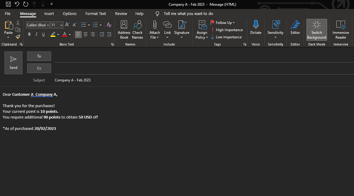

  1. The email draft will be sent to the sales person when I run the UiPath Assistant.
The end result should look like this:-
