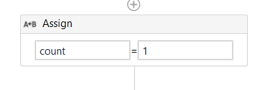

1.First i assigned the count variable with value of 1 ( to add the sheet names)

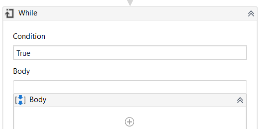

  1. Use while loop with condition as True.
inside the while loop do the following

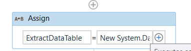

a. Use Assign activity to intiliase the datatable where scrapped page data is stored
in our case , ExtractDataTable = New System.Data.DataTable

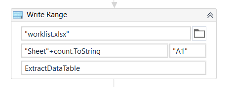

   c. Use write range to write the datatable into the excel file with sheet name as "Sheet"+count.ToString.

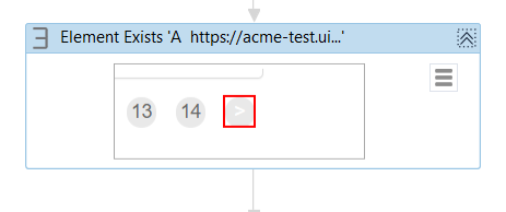

   d.  if the webpage where datatascrpaiing is done is having some forward button where u can move by each and each pages, use this as for element exists and store in boolean variable let's say next_page
next button in this webpage.
We can use this element for checking whether the there is next page or not. so for that we use element exist activity to check that.
(This next button will disppears when comes to last page)

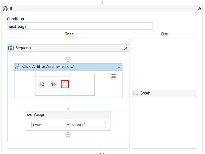

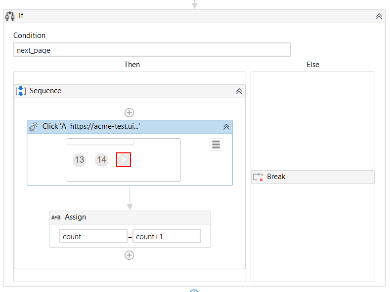

e. Next use an if condition if condition next_page, if the condition is true then in then section , we can use click activity for clicking the forward button and also to increment the count variable by one.
if condition becomes false then it indicates that it is last so scrapping is over so we can break activity to exit out of loop,

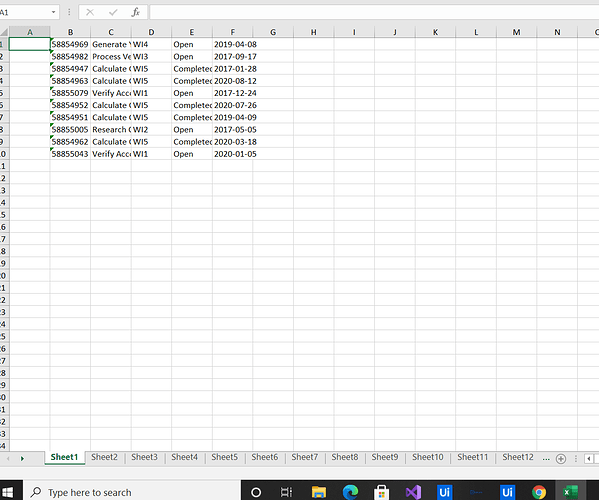

Finally what i get as output of this process is
Each page data is in each sheet , page1 in sheet1, page2 in sheet2 and so on…
